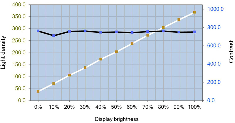

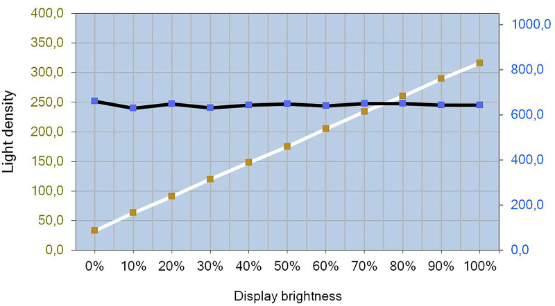

    Van saliendo cositas del nuevo BenQ SW320.
    Por un lado tenemos el lamentable publireportaje de LuLa (alias "forobenq"):
    https://luminous-landscape.com/benq-...onitor-review/
    Donde el revisor ni se molestó en medir la uniformidad porque "el papelito de Benq decía que era buena" (sic).
    Un poco de humor (subrayado es mío):
    Regarding brightness uniformity the SW320’s exceptional uniformity is achieved through a delicate process involving the utilization of high precision apparatus to meticulously fine-tune hundreds of sub-regions on the entire screen. The results of this fine tuning is a noticeable and significant improvement in uniformity over the SW270, and outside of the extreme corners, it measures almost as good as the Eizo CG-318. This is remarkable performance, regardless of price and BenQ is to be commended for their efforts in obtaining this exceptional level of uniformity. You can check how your individual BenQ SW320 monitor performed in its uniformity test on the supplied Factory Calibration Report.
    Perhaps a fairer comparison would be to compare the NEC Sepctraview UHD display against the new BenQ SW320, but unfortunately, I did not have access to this display for a direct comparison.
    I also want to be clear that although I am officially an ambassador for BenQ they have in no way tried to influence my review and instead specifically asked me to be thorough and rigorous in my testing of the SW320
    A mi con lo del NEC PA322UHD es que me entra la risa floja. El PA322UHD "barato" (la versión Multisync) da un máximo de 2% en brillo y 1.2 deltaC con la uniformidad al maximo.
    La review es lamentable y parcial. Benq debe considerar mas rentable invertir en redes sociales que en control de calidad.
    Y por otro lado tenemos una mas seria de ephotozine. Por desgracia no incluyen una validación con DisplayCAL ni una muestra del SPD del monitor (quien lo midió carece de espectrofotómetro). Asi que las validaciones de uniformidad y perfil las realiza con i1Profiler que no es lo ideal, en parte por el programa (sólo lo indica en Kelvin ó du-dv), en parte por la impericia del revisor (sólo uso Kelvin) y tampoco indica la correccióndel colorimetro para el SPD que "supuso" el revisor que dicho monitor tiene.
    https://www.ephotozine.com/article/b...r-review-30428
    Incluye una imagen tomada en blanco para comprobar la uniformidad:
    que como puede comprobarse no es muy buena (y eso que el monitor tenía ACTIVADA la compensación de uniformidad de brillo) pero no es tan horrible como en la inmensa mayoría de LG 31mu97.
    One of the toughest tests for any monitor is how well a monitor can display white. So we've taken a photo of the screen displaying 100% white, with white balance on the camera set using the central point of the monitor. This was taken with uniformity switched on. The monitor has a slight magenta / pink hue on the right-hand side of the monitor, and a slight green cast on the left-hand side of the monitor.
    Me temo que algunos que en público o por mensaje privado me habeis comentado cosas de widegamut low cost (Asus, Dells, Benq...), la última frase os es bastante familiar, por desgracia.
    A su vez el contraste es mas bien pobre (650:1), del orden del esperado en el Samsung U32D970Q con la uniformidad activada... salvo que el samsung SÍ que tiene (uniformidad=ON) una uniformidad de color muy buena (pasaría test ISO 12646 en sus últimas revisiones).
    De momento este Benq es un producto mas en su rango de precios (widegamut lowcost 32" UHD), de momento algo por encima de la media... que el LG 31mu97 se encargó de bajar y mucho (samsung > dell, benq, asus >>> LG... el HP z32x esta en paradero desconocido).
    En cualquier caso esta claro que el SW320 NO ES la fantasía que el revisor "imparcial" de LuLa os presenta.
    Si quereis uniformidad impecable con un presupuesto sobre 1500€
    -si renunciais al contraste y asumis una calibración híbrida GPU + hardware (por limitaciones del software): Samsung 32 4k
    -si necesitais contraste aceptable para web, multimedia o video: NEC o Eizo en 27" 2560x1440.
    Actualizado 20/01/17 a las 14:55:52 por ColorConsultant
