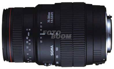

    EL OBJETIVO
    DISTRIBUCIÓN LENTES
    LAS ESPECIFICACIONES
    Lens Construction 14 Elements in 10 Groups
    Angle of View 34.3degrees - 8.2degrees
    Number of Diaphragm Blades 9 Blades
    Minimum Aperture F22
    Minimum Focusing Distance 150cm / 95cm(Macro mode)
    Maximum Magnification 1:4.1 / 1:2(Macro mode)
    Filter Size Diameter 58mm
    Dimensions Diameter 76.6mm X Length 122mm
    Weight 545g
    Corresponding AF Mounts SIGMA,
    CANON,
    NIKON (D),
    MINOLTA,
    PENTAX
    Telephoto zoom lens with excellent cost performance
    This is a telephoto zoom lens with excellent cost performance. It is capable of macro photography with a 1:2 maximum close-up magnification at the 300 mm focal length. It’s the ideal high performance lens for portraits, sports photography, nature photography, and other types of photography that frequently use the telephoto range.
    SLD (Special Low Dispersion) glass
    We used SLD (Special Low Dispersion) glass in this lens for excellent correction of chromatic aberration. Also, we effectively corrected for fluctuation of aberration due to focusing.
    Macro shooting with maximum magnification 1:2
    It is capable of macro photography with a 1:2 maximum close-up magnification at the 300mm focal length. The minimum focusing distance is 1.5 m/59 inches at all zoom settings. It also has a switch for changeover to macro photography at focal lengths between 200mm and 300mm with a maximum close-up magnification from 1:2.9 to 1:2.
    Without changing the distance between camera and subject, you can change the shooting magnification.

    CUIDADO !!!! LA FOTO QUE PONES NO ES LA DEL APO
    Si te fijas, pone claramente "DL". No es la foto del APO. No confundáis estos 2 objetivos. El modelo DL es exactamente igual, con las mismas características, tamaño y diseño, pero no tiene los cristales apocromáticos que son los que evitan las aberraciones. Evidentemente, es más barato que el APO, unos 150€ (dependiendo de la tienda). A ver si alguien se va a confundir, va a ver el DL a 150€ y se lo va a comprar creyendo que es el APO (vaya ganga).
    Otra forma de reconocer el APO, aparte del letrerito impreso en él, es que en la versión para Canon, va pintado un aro en rojo, al estilo de los L de Canon.
